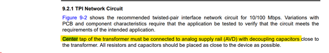

Although the datasheet states that center tap of the transformer must be connected to AVD, is it also OK if I connect it to VDDIO? (VDDIO = 3.3V)

It has to be AVD, even if the voltage level is the same.
Alvaro
Hi Roy,
It's because the IOs are connected VDDIO and their constant toggling creates more noise that may impact device behavior,
