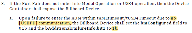

Hello, I have question about billboard with TI TPS65988DK(PD) + TUSB8044A.
In billboard spec description:
There have explain about bmconfigured field setting for 01b / 10b / 11b.

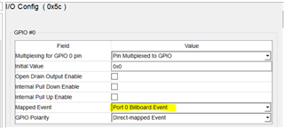

And, in HUB TUSB8044a spec:
But, in TPS65988DK application, i didn't see GIO event setting for bmConfigured IO.
How to support billboard by our current solution (TPS65988DK + TUSB8044a)?

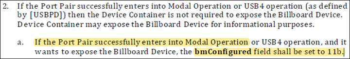

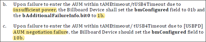

And, I also found addition description in USB billboard spec:
It seems TPS65988 + TUSB8044a used for static billboard design, right?
If so, what's "static billboard" definition?
