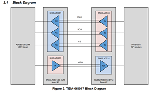

Isn't the LVDS receiver and driver changed in the block diagram for TIDA-060017?
LVDS Receiver : SN65LVDS33(blue block)
LVDS Driver :SN65LVDS31(pink block)
