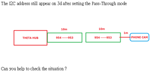

Customer use two pairs 983 984 to connect camera and SoC with 30M wired.
They faced some problems in I2C communication. Is there any way to avoid it?

    yes!954-953-954-953!please refer below.
    How would we connect the second 954 for same i2c address?
    Is it bypass mode at first stage 954-953?

  • If you are asking because you want to communicate with the Image Sensor through all these devices, then you can use the pass-throu mode by assuming the first 953+954 is link A and the second 953+954 is link B, and the image sensor as Adress 0xXY:
    SoC --> 954 (A) --> 953 (A) --> 954 (B) --> 953 (B) -->Image Sensor
    Program 954 (A):
    0x58[6]=1 for Pass-throu enabled
    0x5D: SlaveID[0] = 0xXY
    0x65: SlaveAlias[0] = 0xXY
    Program 954 (B):

    Current test result
    - 1 serdes (0x3d) with our camera sensor. OK
    - 2 serdes (both with the same address 0x3D) + mipi sensor. FAILED
    detail info

    - 2 serdes (both with the same address 0x3D) + mipi sensor not ok

    1-2==>default ==>0x3d (both ) beacause it's cascaded PR production cable *2 and we can't set the I2C address via I2C seperately
    3==> 0x10
    4==> I had tried it. it is useless as figure.
    When the customer string together two groups of 953 954, and give an instruction to change the address, it will be changed to two groups at one time, and there is no way to change it separately.
    Is there any way to separate the commands for these two groups?
    It can't sensor the 2nd 954 I2c address(default 0x3d) on the cascade SerDes structure even HUB sets the different 0x3C on 1st 954.
    Could you apply the command for real cascade SerDes experience?
    Customer use the pass-throu mode by assuming the first 953+954 is link A and the second 953+954 is link B, but still fail.
