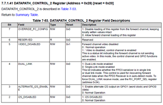

Hello team,
My customer found 948 in their display output I2S/MCLK from GPIO8/9. and they are  aware those clock output worsen some EMI performance.
It looks SER 949 enable I2S unintentionally.
Could you pls let me know how to forced disable I2S feature at DES not to have those clock output??
Or only what I found is GPIO8/9 configuration to low to disable this clock output.
