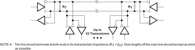

  • Hi Himanshu,
    So this is not within spec for RS-485 systems and the reason you are seeing stability issues is at least partially due to the system setup.
    1. System Topology should either be daisy chained or use junction boxes.
    2. In the RS-485 systems only the first and last nodes on the bus are terminated and this resistor value should be 120 Ohms.
    3. The pull up resistor on A  - to bias the 'A' line only 1 node needs the external pull-up - it is not required on every node. This is the same for the pull-down on "B".

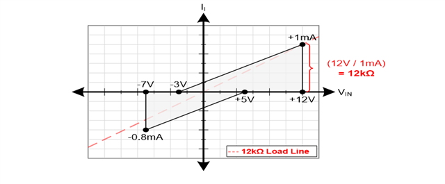

    4. The impedance on the "A" line to ground needs to be >= 375 Ohms. This can be found by taking the effective parallel impedance of the pull-up resistors and the input impedance of the RS-485 transceivers (where input impedance is #nodes supported * 375 - so for this device 12K). The same analysis and conclusion can be drawn on the "B" line as well.
    Essentially RS-485 bus should more or less look like this:
    The above picture doesn't include bias resistors - but those are acceptable.

  • Hi Himanshu,
    1. I think I wasn't clear enough - when I said junction boxes - I meant junction box + backbone - please see below (bottom left):
    I am not 100% on your topology - I think it may be closer to a start network - which isn't ideal for RS-485 buses.
    2. Ok - so this termination style is suggested - but it only works well due in the bottom two topologies. I think you may have a star network which would require terminations on every node - and the 120 Ohm is too low for 25 nodes + when adjusting to a higher termination you get a lot of reflections. Even if the data rate is lowered - the transition speed is fixed and the harmonic content from the transition (which is fast since this part is at 35Mbps max data rate) will reflect. We have tested a system that can work in a Star network - but the caveat is that it includes line drivers and we tested it with a special RS-485 device (THVD8000) which uses OOK modulation on the bus signal - I have added a note here: https://www.ti.com/lit/an/slla573/slla573.pdf?ts=1664204264810&ref_url=https%253A%252F%252Fwww.google.com%252F but we don't have data that would support using this with other parts - but it may be possible. Using the line driver allows 120 Ohm terminations on multiple nodes without overstressing the driver on the RS-485 transceiver itself.
    3. Fail safe resistors are only needed at one node as long as all the nodes are connected. There is a slight issue however - fail safe resistor values should be at 680 Ohms to set an idle voltage of about 200mV (680 from VCC to A and 680 from B to GND assuming an eq. termination resistance of 60 Ohms) however this violates the impedance from A or B to ground  (minimum 375 Ohms)- as the condition for minimum fail-safe value is: R_FS >= (375 * R_in) / R_in - 375). Which for this setup R_In = 12K/25 = 1.714K ohms which won't set a proper idle voltage. That being said - if 680 is used  there may be a bit more attenuation on the differential signal than spec'd as its out of range however I don't think the impedance is low enough to cause damage if the 680 is used.
    4. The RS--485 standard dictates a input leakage vs bus voltage spec called the unit load
    One of the corners is 12V and 1mA  which gives 12K of input impedance.  The 12K load line is a standard approximation used to simplify the input impedance of the device. This is a standard RS-485 device that is rated for 1 Unit load which is 32 nodes on a bus. The 32 nodes when taking the 12K ohm in parallel is equal to 375 Ohms (12K / 32 = 375). The 375 Ohm also is what is used as common mode loading to simulate a fully loaded bus when testing the device under the common mode ratings. So on devices with 1/2, 1/4, or 1/8 unit loads we can approximate the input impedance as 24K, 48K, and 96K respectively. It isn't always necessarily going to be the appx. impedance but it is a good estimate of how RS-485 devices behave. This device specifically supports 32 nodes so the eq. input impedance can be approximated as 12K.
    The reason you take them in parallels is that an RS-485 bus with 25 nodes has the "A" pins in parallel with all of the A pins and the same can be said for the B pins with all the "B" pins. The nomenclature is a bit weird because there are a lot of shortcuts/assumptions built in. I have added a design guide that really covers the basics of RS-485 design that is super helpful: https://www.ti.com/lit/an/slla272d/slla272d.pdf?ts=1664206175196&ref_url=https%253A%252F%252Fwww.google.com%252F - also if you can access the RS-485 standard it isn't very long of a read and it may have some more information - but the design guide I attached above is going to be very helpful in most applications.
