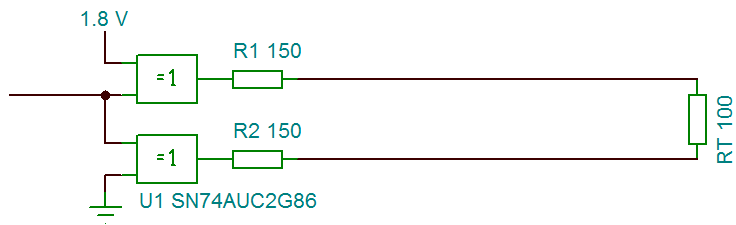

Hi I was looking at the SN65LVDS4 which looks like a pretty cool 1.8V part. On the data sheet in typical application circuits it shows a single ended to differential driver providing the input for this part. My question is does such a part exist, or does TI have plans to release such a part any time soon ? For example the SN65LVDS1 and 2 function as a pair but are 2.5V/3.3V but not specified at 1.8V operation. Any thoughts? Thanks Steve
