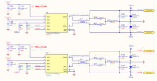

Hi team
There is a good new that we DIN TCAN1044AV-Q1!
Please help confirm the SCH is ok?

Kygo,
Both placements of TCAN1044A-Q1 are correctly designed. CAN bus components are complete with CMC, termination resistance, and protection components, both power inputs are correctly decoupled, and the logic pins (TXD, RXD, STB) are connected to the controller, as expected. Please let us know if you have any other questions.
