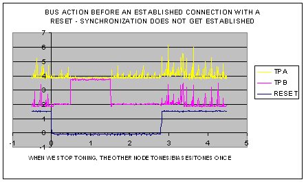

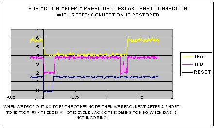

  • Here are two scope captures for now (keep in mind it is only a 150MHz scope):
    WHEN WE DROP OUT SO DOES THE OTHER NODE, WE CAN RECONNECT AFTER
    A SHORT TONE FROM US - THERE IS A NOTICEABLE LACK OF INCOMING TONING
    WHEN BIAS IS NOT INCOMING.
    WHEN WE STOP TONING, THE OTHER NODE TONES/BIASES/TONES ONCE.
    I'm working on schematics and bus analyzer traces.
