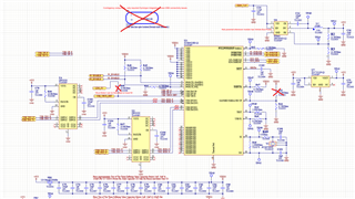

This is a new chip for me; the hub shows up on the host, both Windows and Linux, but windows indicated driver issues and Linux says "can't open device"... Anyone encounter this before?

Do you have a unprogrammed EEPROM connected to the hub? If this is the case, can you remove the EEPROM and see if the hub can be recognized by the Win or Linux with its default TI VID and PID.

Apparently the pull-ups on the I2C/SMBus were preventing default configuration from loading
Awesome, thanks for the update and I am glad you are able to solve this issue.
