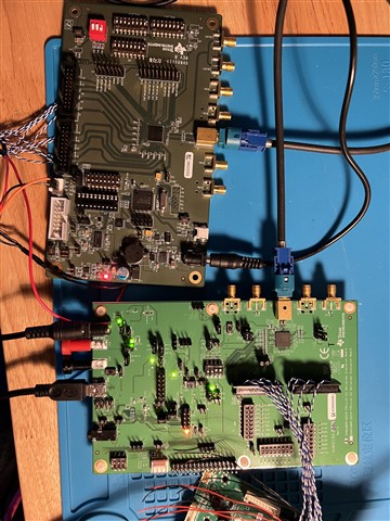

Hi all. I cannot get a link working on my DS90UH948-Q1EVM from a DS90UB949-Q1 serializer. The same serializer and cable are providing a link to a DS90UB948-Q1 without issue. I've tried toggling the PDB switch after I know the link should be good, but am having no luck.
Here is a photo of my EVM's jumper and DIP switch settings:

    Is your power supply on? The LED3 light should turn on when properly connected to power supply. I do not see that led on in the image of your setup.
    Respectfully,
    William Y.
  • The board was off when I took that photo, but was powered on when I was testing/grabbed those ee dumps.
    I’ll take another photo with it powered up as soon as I get back to my bench. Thanks!
  • Hi Adam,
    Ok, no problem. I just wanted to spike out the obvious before diving in deeper to your setup.
    I have it working on my bench right now. Can you also take a picture of the serializer as well?

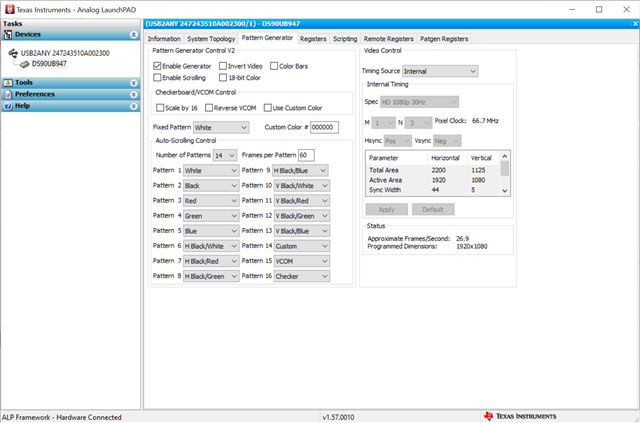

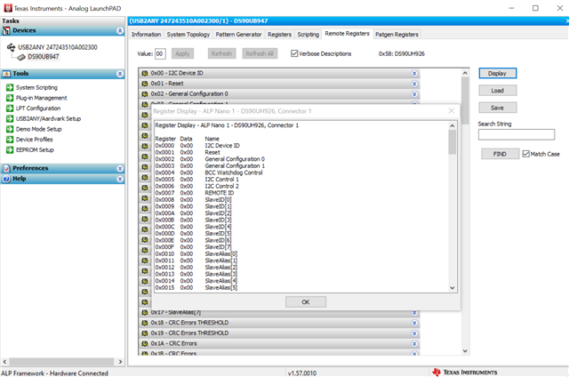

  • Here's a photo of the deserializer EVM powered on:
    Sadly I do not currently have a serializer EVM; the serializer I am connecting to is in an existing product (but I do have control over it, can change register values, etc).
    Here's a screenshot of the what the EVM comes up as in ALP:
    Since there is no link, I can't see the serializer over the i2c backchannel. However, if I directly connect the i2c lines of the serializer and deserializer together, I can see both in ALP via the deserializer's built in USB2any:

  • Hi Adam,
    Lets take it a step back. I have strapped my EVM's with the same IDX and mode selection setting from your register dump.
    Can you try implementing these default register values on your setup?
    Here is a register dump for the 949 that I have that is working on my side:
    Register Display - ALP Nano 1 - DS90UH949, Connector 1

  • Ok, I received my new hardware, including a DS90UB947-Q1EVM serializer board.
    I was unable to find any replacement for my DS90UH948-Q1EVM (not even the DS90UB948-Q1EVM); they seem to be sold out everywhere.
    Even connecting the serializer EVM directly to the deserializer EVM, I am still unable to get a link.
    Here's a photo of the current setup:
    I will try and reset the registers to factory defaults shortly to see if it makes any difference.
  • Hi Adam,
    Thanks for reaching back! This is sounding more like a defective DS90UH948-Q1EVM device issue.
    Do you have an image of the setup through ALP?
    I am setting my evms back to match your images to see if I can replicate the situation.
     Respectfully,
    William Y.
  • This is what ALP looks like connected to the serializer (the deserializer does not enumerate via i2c over the fpd link).
  • Hi Adam,
    Do you have forward channel? There needs to be video input to enable lock between the 947 and 948.
    Click pattern generator tab -> timing source set to internal -> enable generator.
    Can you try this to see if you can see the 948 from the 947?
    I thought you had forward channel but was unable to get back channel.
    Respectfully,
    William Y.
  • I should; I was sending the 947 1920x1200 @60Hz via LVDS. I tried the generator tab (changing clock from external to internal) and power cycled the 948 (and also just tried toggling PDB).. same results.
    When connected to the 947 via USB/ALP, if I toggle PDB on the 948, I do see the "partner information" section in ALP grey out (and "linked to deserializer" change to No in the UI), but it still shows up as a different model deserializer and I am unable to see it via i2c. But that tells me there is at least some communication over the FPD Link...
  • I attempted to reset all registers on both boards. Here are the current values according to ALP:
    Register Display - ALP Nano 1 - DS90UB947, Connector 1

  • Hi Adam,
    Yes, I see that your 0xC register is set to 0x17 hex. This indicates that their is indication of link between the 947 and 948. Could you try a simple read from the 947 to the 948 on the scripting tab and see if you are able to read remote registers? i.e board.ReadI2C(devAddress, register)
    or go to the remote register tab on the 947 and see if you can see if you are able to get register access of the 948?
    Respectfully,
    William Y.
  • All remote registers just show up as 0x00:
  • Hi Adam,
    Unfortunately there appears to be a problem with the UH948 EVM board. Is there any way that you can get your hands on a different UH948EVM?
    I'm reviewing all the information and will get back to you with some debug direction soon.
    Respectfully,
    William Y.
  • I’ve been looking everywhere for one and have come up empty so far. Do you think it’s the deserializer itself that is bad? I could try reworking the board…
  • Before I start desoldering things... can you validate the jumper settings on my DS90UH948-Q1EVM?

  • Hi Adam,
    That all looks good on my end. I also have modesel1 set to 1 and all others off. The rest of the pins on the 947 I have as open.
    I do not believe that there is an application issue on your end.
    Respectfully,
    William Y.
  • Yes, same. I have S6 (modesel1) with 1 on and all others off.
    I also have S5 as: 1,2: Off 3,4: On
  • Hi Adam,
    Yup, it is the same. I do not think their is a configuration problem as much as a connection issue. Like Casey mentioned before, there may be something wrong with the connector?
    Respectfully,
    William Y.
  • Looks like it was in fact a defective deserializer IC. I desoldered the DS90UH948-Q1 on the EVM, and reflowed a new DS90UB948-Q1 in its place. I am now able to successfully establish a link using the exact same cables and config. I just tried a color bar test, which was also successful.
  • Perfect! I am glad it is working now
