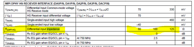

We are designing a new notebook and want to use your SN75DPHY440SS as our Camera retimer.
I had question below.
In data sheet page 7, it’s said that Differential input impedance can be 80-125 ohm.
But in page26, chapter 10 section 1(10-1) layout guidelines, it is said that DA and DB differential impedance should be 85-115 ohm(100 +-15%).
Which one is correct?
Meanwhile, I want to use 90 ohm(+-10%) to implement my DPHY signals, if this product can only support 85-115 ohm, can you suggest another product which can support at least 80-100 ohm?
