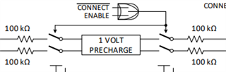

    I'm looking at the functional block diagram here and I don't really understand what is meant by the combined AND/OR symbol. Can you explain what that symbol means please?
    If it works like an OR, then I suppose I get the pre-charge even if ENABLE is low, because CONNECT will be low.
    Thank you.
  • If I interpret the description in the datasheet correctly, the pre-charge always happens at power up, even if ENABLE is low.
  • I think I see what you're getting at. Taking a look at the Pin Functions table it states that the pre-charge circuitry is active during initial power up.
    But after initial power up, if the enable pin is low then the pre-charge is disabled, so that's no good - at least not for the application I'm proposing where the TCA4307 is on the backplane and permanently powered.

  • Can you change the card connector so that the buffer is powered with a trace that is connected through the card?
  • That's a good idea - thanks. It sounds like that achieves the buffer effectively behaving as though it is on the card.
    I could probably either loop power via the connector, or use a "presence" signal pin to toggle power to the buffer via a FET.
    So I think this is what happens:
    • On card insertion, buffer is powered as soon as possible (early-mating connector pins).
    • ENABLE is tied high, so pre-charge immediately becomes active until connection.
    • Shortly afterwards, the i2c signals from the card mate and connection is ready to be made once the bus is idle.
