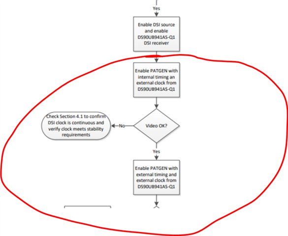

  • Selva,
    Can you verify the step are you are in the DSI Bring up Flow? The CRC issues seem like a potential result of misconfiguration with the DSI source. If you can help me with the below flow chart, we can cross check the usual suspects like LP11 transitions and EoTp generation. Also are there any reported visual effects with the boards with CRC errors when using external timing patgen?
    Shu

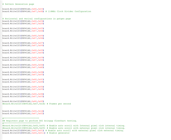

  • Hi Shu Huang,
    Do we need to configure the patgen registers to run with external clock internal timing?
    If I run the patgen , without configuring the horizontal and vertical resolutions in the patgen page
    1) external clock and external timing or 2) external clock with internal timing I am seeing a CRC error.
    If I configured the Patgen registers with the above Horizontal and vertical configurations and run the 1) external clock with external timing or 2) External clock with internal timing.
    What is the right method to test these two modes?
    selva

  • Okay, I didn't configure the patgen registers for internal timing. (Resolution and polarity of Hysnc  , Vsync etc ). Now those registers are taken its default values.
    In that case. Consider I am running the external clock and internal timing test case.
    Is the pattern test takes DSI resolution or my patgen register resolution and timings? (i.e. default configuration in the registers as per the datasheet.)
    In this scenario, I am getting a CRC error.

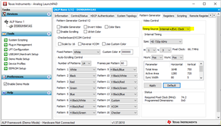

  • Hi Selva,
    In external clock and internal timing mode, the patgen timing registers such as the resolutions and polarity need to be configured. The pattern test will take the patgen resolutions and cannot be left to the default values.
    If you are using ALP, there is a built in Pattern Generator tab that will help with the configurations.
