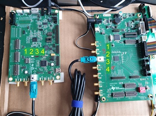

I am trying to evaluate DS90UB949-Q1EVM using SV600978-003 REV B devkit connected via 4 pin FAKRA connector to the DS90UB948-Q1EVM using SV601029-002 REV B
I have an LVDS dispaly and using SV601029 and these settings
I can get the test pattern to appear on the screen.
But when i apply the same settings to SV600978 development board i get nothing:
No link detection, pixel clock or anything. I have tried default switch configuration and many options - Coax/Twisted; dual/singe, OLDI/SWAP, and nothing.
I would like to ask you for help, what to test next.
