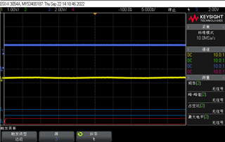

My product is SOC+DS90UH941+DS90UB926.
I used oscilloscope and tested DS90UB926 pin, PCLK pin has clock signal output and frequency is right, but VS and HS pin no signal output and always high.
The figure below (blue signal)is DS90UB926 HS signal I tested:
The figure below (blue signal)is DS90UB926 VS signal I tested:
I used Pattern Generator in DS90UH941, then I can see the VS and HS have some signal output.
Below is the commander I used
# i2cset -f -y 3 0x0c 0x65 0x0     // Pattern Generator Configuration
# i2cset -f -y 3 0x0c 0x64 0x05    // Enable Pattern Generator
It looks like the problem in the SOC DSI output or DS90UH941 register configuration.
I don't know if there are any registers that need to be configured to output the VS HS signal in DS90UB941.
