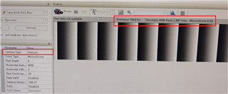

    But we are using UB927 which can support to 8192*1000@24fps mono 8 in Camera Link line scan mode, but not support this resolution in frame scan mode.
    The display resolution 4096*480@166fps is shown as follows(3 ICs run together in camera test pattern mode).
    UB927 can support 720P(1280*720*60*24) in SPEC, while 8192*1000*8*24<720P(1280*720*60*28)
    Could I understand that UB927 can support to  8192*1000@24fps mono 8 mode?
    Thanks.
    Doncheng.
