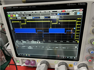

Issue:
ub940 lock status ok,but soc mipi receiver can not sync to valid mipi clock.
Test has been done:
1.We monitored the mipi clock with the oscilloscope and the result is as below:
By comparing with the correct board, we discovered that the voltage amplitude of mipi clock of the failed chip is  829 mv,which is larger than the max value in mipi dphy specification(500 mv). The part number of the failed chip is dsub940n.
2. In our software start up sequence, first we set ub940 test pattern with internal clock and then close test pattern and switch to normal mode. We close the test pattern and let the chip work directly in normal mode and the black screen can not be displayed.
Could you please explain in details that why closing test pattern can avoid black screen issue?
3. We did fota update of the whole system and when the system restarts from fota update, the i2c communication between the host machine and ub940 can not work. When we apply the oscilloprobe to measure the i2c waveform, the communication recovers. Could you please explain why?
Thanks in advance!

  • Hi Wendy,
    2. Have you tried using patgen on the 927? This would give us a better indication of the system's status since the video has to go across the link.
    3. The soft reset is most likely the cause of the i2c communication failure. Can you try power cycling the ub940 to see if that restores i2c communication after fota update?
    Would you also be able to provide register dumps for the ub927 and the ub940?
    Jack
  • 2. Have you tried using patgen on the 927? This would give us a better indication of the system's status since the video has to go across the link.
    ub927 is not on the host machine,we know nothing about the machine with ub927 carried on. It is owned by another company. We don't know its iic address. Is it possible to use other method to solve this problem?
    The ub940 pwd is directly connected to VCC and it can not be toggled down. Is there any other way to solve this probem?
    Best Regards
    Wendy
  • Hi Wendy,
    2. Do you know the video timing/resolution coming from the UB927? There are certain supported video resolutions for the UB940. If the display cannot sync to the video signal, it will not display any image. I will attach an app note about configuring UB940 timing parameters for your reference.
    App Note: Link
    3. There is some errata related to digital resets that should be implemented if not already.
    • Before a DIGITAL RESET1 or DIGITAL RESET0, set the CSI indirect address (CSIIA) register to point to an unused register location (0x6C=0xFF)
    • After issuing a DIGITAL RESET1 or DIGITAL RESET0, wait >=500us before accessing any registers via I2C
    Jack
