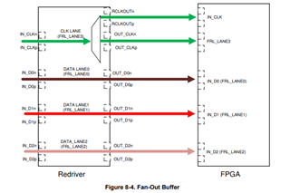

I am looking to design an FPGA-based PCBA for video processing. I'd like to have an HDMI 2.1  input and HDMI 2.1 output.
The HDMI signals will connect to 16Gbps high-speed serial transceivers on the FPGA. But I will need signal conditioning.
About 6ft copper external cables will be used.
PCBA approximation: FPGA->1 inch trace->high speed connector->2 inch trace->HDMI IC->1 inch trace->HDMI connector
What is the difference between the TDP1204 and TMDS1204? which should I use?
