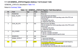

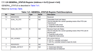

    On the 948 side, you can check register 0x1C bit 0 for lock status.

    For 948 0x1C[0], does the bit indicate the lock status at that time? Or if the lock status changed the bit should be '0'. I concern that the unlocked status only occurred when we was doing ESD test. After ESD test, it will be recovered. So we may need lock status changed register.

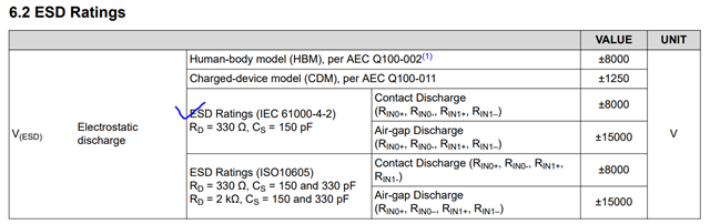

    In addition, as you can see below, our chip can meet below system level ESD, does it mean that we can suffer this spec and IC won't be damaged or abnormal in this spec? Thank you.
    Roy
  • Hey Roy,
    Yes, that's correct. This bit will reflect the status of the lock at the given time of capture.
    Correct, those are the specs for device tolerance to ESD events.
    Sometimes with ESD testing you get a discharge spike which goes beyond datasheet ratings. Those spikes can damage the device or cause functional issues like loss of lock, flicker, etc. Effect of System level ESD:
    • Soft error such as occasional Link drops but system recovers (Self-healing or may need RESET)
    • Physical Failure (Damage to the Device)
    Some of these issues are due to the direct capacitive coupling with the gun tip.
    Also, ESD testing is heavily influenced by connector, harness, choke, enclosure, Instrument Noise Floor etc.

  • Hi Roy,
    You can check register 0x1C on the 948 side to monitor lock status.

  • Hey Roy,
    When doing ESD testing, loss of lock is expected. The passing criteria is if our device recovers after losing lock. If it recovers then it's passing if it doesn't recover then it's a fail. 0x1C will report the current state of the lock at the time of reading this register.
    If lock is established, bit 0 will be high, if no lock is established it will be low.
    Fadi A.

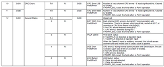

    On 947 side you have 0x0C register which shows valid PCLK is detected on the ODLI input and cable link is detected as well.

    I want to check 0x0C register information. From our scenario, our panel only showed the abnormal output when doing ESD test. But after ESD test, it can be recovered automatically. So we want to know whether the abnormal phenomenon is from FPD-link or not. Unfortunately, we didn't face the issue when using TCON patgen or 984patgen. So customer think the reason is from FPD-Link.
    So I want to find some registers that can indicate that there is no fault when doing ESD test to point out our SerDes link is ok when we was doing ESD test.
    For 0x0C[3] and 0x0C[1], can I say if there is no error detected after doing ESD test which means the link between SerDes was normal during ESD test?
    For 0x0C[2], I think the bit is that when we use oLDI input, is it correct? For the case, we used 947patgen.
    For 0x0C[0], I think the bit can't indicate the useful information. Because we found the panel output is normal when after doing ESD unless we can monitor the bit during ESD test. Because ESD test was inserting energy at a moment, I'm not sure if we can read the correct data when during the ESD test.

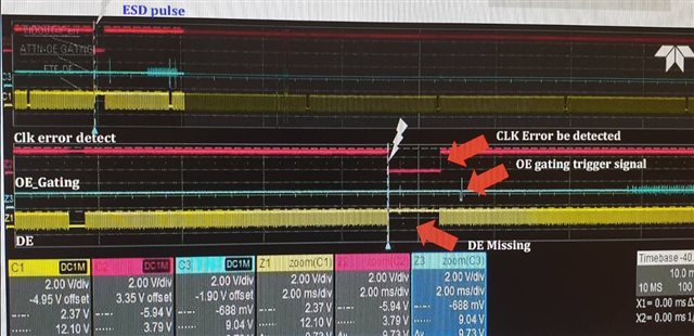

  • Hi Fadi,
    One information want to align with you. Attached image is measured by source IC vendor. It said that our 948 didn't send DE signal when did the ESD test. The duration is about 1.x ms. But we didn't meet the issue using 948patgen, but 948patgen used lower PCLK due to limited PCLK.
    If there is any register can check the DE status?
    Roy
  • Hey Roy,
    So HS and VS are checked also and they look fine but only DE is missing?

  • Hey Roy,
    Can you also check the lock signal while DE signal is lost ? Is this DE signal loss happening in conjunction with loss of lock?
