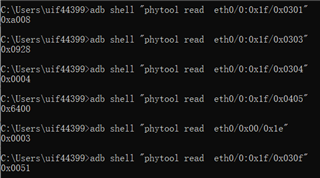

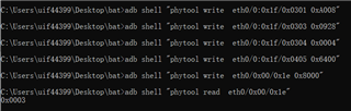

My customer is testing the TDR function of DP83TG720R-Q1 and meet some questions. Please support on this.
They refer to the procedure which described in this apps note
Procedure:
  • DP83TG720R-Q1 as slave
  • manually open the MDI cable
  • TDR configuration: Pre-run
    • reg[0x0301] = 0xA008, reg[0x0303] = 0x0928, reg[0x0304] = 0x0004, reg[0x0405] = 0x6400
  • Start TDR
    • 0x001E[15] = 1
Result:
  • read 0x1e=0x0003
  • read 0x030F=0x0051
Questions:
  • Why 0x1E show TDR fail?
  • May you kindly review the test procedure to see if any mistakes?
Below are the screenshot for register setting and read.
Thanks!
Ethan Wen
