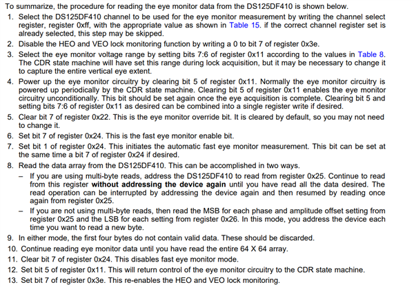

    I may have given you inaccurate info about the the unlocking issue. We noticed the intermittent unlocking issue after running the eye-capturing sequence, not after resetting the CDR (sorry about that). Sometimes, the CDR goes unlocked (and stays unlocked) after running the sequence but may be recovered by running it again.

    Do you see any issue with the sequence that causes the CDR to unlock after running it?

  • Hi Child,
    I don't see anything that appears obviously wrong with the procedure you have.  However, I did notice that it deviates a bit from the procedure in the datasheet.  I believe I have modified your code to closely follow the procedure from the datasheet.  Could you test the procedure below to see if there is any change in behavior?
    One difference that I did note between your code and the datasheet was the order between disabling heo/veo lock monitoring function and powering on the eye monitor circuitry.  Not sure if this would have any real world impact though.

  • Drew,
    Your sequence seems to be more stable. But it does not let us set the Vrange manually. Instead, Vrange's are set automatically. What should be changed to make Vrange manually adjustable?

  • Hi Child,
    Glad to hear this is a more stable sequence.
    Vrange override can be accomplished by clearing bit 6 of register 0x2C.  I would clear it after configuring register 0x11.  Updated sequence below.

  • Drew, that works quite well. Thanks!
