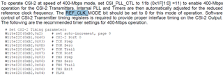

I have checked datasheet guide to add some CSI timing params as below.
Q1 ) Customer only need to add those timing params and change 0x1f to 400Mbps?? or other register is needed more for 400Mbps??
Q2) I cannot find REF_CLK_mode register. what address is for it??
Q3) For net BW, datasheet says 800Mbps/400Mbps only support up to 1.6Gbps/0.8Gbps per RX port.
Does it mean SER cannot receive 3Gbps data even configure 800Mbps 4lane CSI output data rate??
if so, Customer cannot use 400Mbps data rate because SER input total data bw is 1.188Gbps. Am I right??
