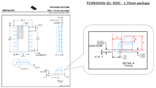

Hi there,
We would like to know the dimensions of the TCAN1043-Q1 SOIC package that are not listed in the datasheet.
Please answer the dimensions A to C described in the attached file.
If there are no dimensions, we would like you to present the measured values.
  • Hello Keiji-san,
    A.   This would be these two values subtracted from each other divided by two. So 0.6 - 0.5 mm.
    B. I will have to check with my packaging team. Why are these values needed?
    C.  This would be these two values subtracted. So 1.5 - 1.65 mm
    Chris
  • Hello Chris-san,
    Thank you for your reply regarding dimensions A and C.
    I will answer your questions below.
    Because I would like to understand the difference between the packaging of this product and other companies' products.
    However, since dimensions A and C were the same, I assumed that dimension B would be the same.
    Therefore, this issue will be closed.
    Thank you very much.
