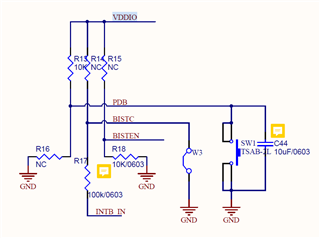

Hi Jeff,
Per the 947 datasheet, with a 3.3V VDDIO, a high level voltage is >2.1V and low level voltage is <1.15V. The measured 1.9V PDB is considered unknown state and would prevent the IC from functioning properly and locking. Is the above schematic you shared the customer board?
Shu
