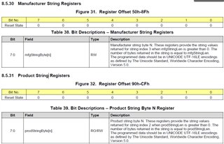

Hello, I had question about "Manufacturer String", and "Product String".
In spec for TUSB8044a as below:
==> It is for HUB configuration. How about is billboard?

Billboard is from 27h to 2D
Brian
Dear Brian
I think you may misunderstand.
For HUB, I can modify manufacture string and product string, and it can be view by USB viewer, for example
iManufacturer and iProduct.
Where to setting for billboard device. It is always 0x00
BR
Kanter.Lin

Dear Brian
In my understanding and study, it is for billboard pop message, not for product string and manufacture string.
Could you clarify it?
Please check it by USB viewer. (Free tool)
BR
Kanter.Lin
You are right, 100h seems not for product string and manufacture string of billboard.

Kanter:
Design confirmed That TUSB8044A don't have register for billboard manufacture and product information like those at 50h and 90h.
