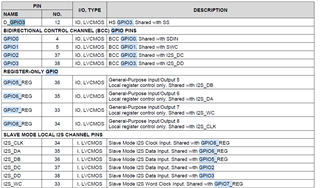

3. In the above, I just want the 2-channel output from the Serializer, so just using I2S_DA for the Serializer, rest the I2S_DB, and I2S_DC pins of I2S, I want to use them as a normal GPIO mode, as, mentioned below in datasheet
as these pins are shared by I2S pins, so when I am configuring them as GPIO output pins using 0x0E, 0x0F, and 0x10 register, I am not able to control the GPIO pins of I2S_DB, I2S_DC, and I2S_DD. Please share me how can I use them as normal GPIO output pins.
    No you can't use the I2S/GPIO shared pins as GPIO when using HDMI audio function. You need to disable HDMI audio function (Register 0x55 bit 6 (HDMI_I2S_OUT) to be able to use them as GPIOs.

    Ok. I got it. Can you please tell me other GPIO pins that I can use as an output pin from the Serializer?
    In normal operation, GPIO[3:0] may be used as general-purpose I/Os in either forward channel (outputs) or back channel (inputs) mode. GPIO and D_GPIO modes may be configured from the registers. The same registers configure either GPIO or D_GPIO, depending on the status of PORT1_SEL and PORT0_SEL bits (0x1E[1:0]). D_GPIO operation requires 2-lane FPD-Link III mode See Table 1 for GPIO enable and configuration
    For back channel config:
    The D_GPIO[3:0] pins can be configured to obtain different sampling rates depending on the mode as well as back channel frequency. These different modes are controlled by a compatible deserializer. Consult the appropriate deserializer datasheet for details on how to configure the back channel frequency. See Table 2 for details about D_GPIOs in various modes.
    For GPIO_REG[8:5] Configuration
    GPIO_REG[8:5] are register-only GPIOs and may be programmed as outputs or read as inputs through local register bits only. Where applicable, these bits are shared with I2S pins and will override I2S input if enabled into GPIO_REG mode. See Table 3 for GPIO enable and configuration
    Note - Local GPIO value may be configured and read either through local register access, or remote register access through the Bidirectional Control Channel. Configuration and state of these pins are not transported from serializer to deserializer, as is the case for GPIO[3:0].
    Those are all the GPIOs highlighted.
