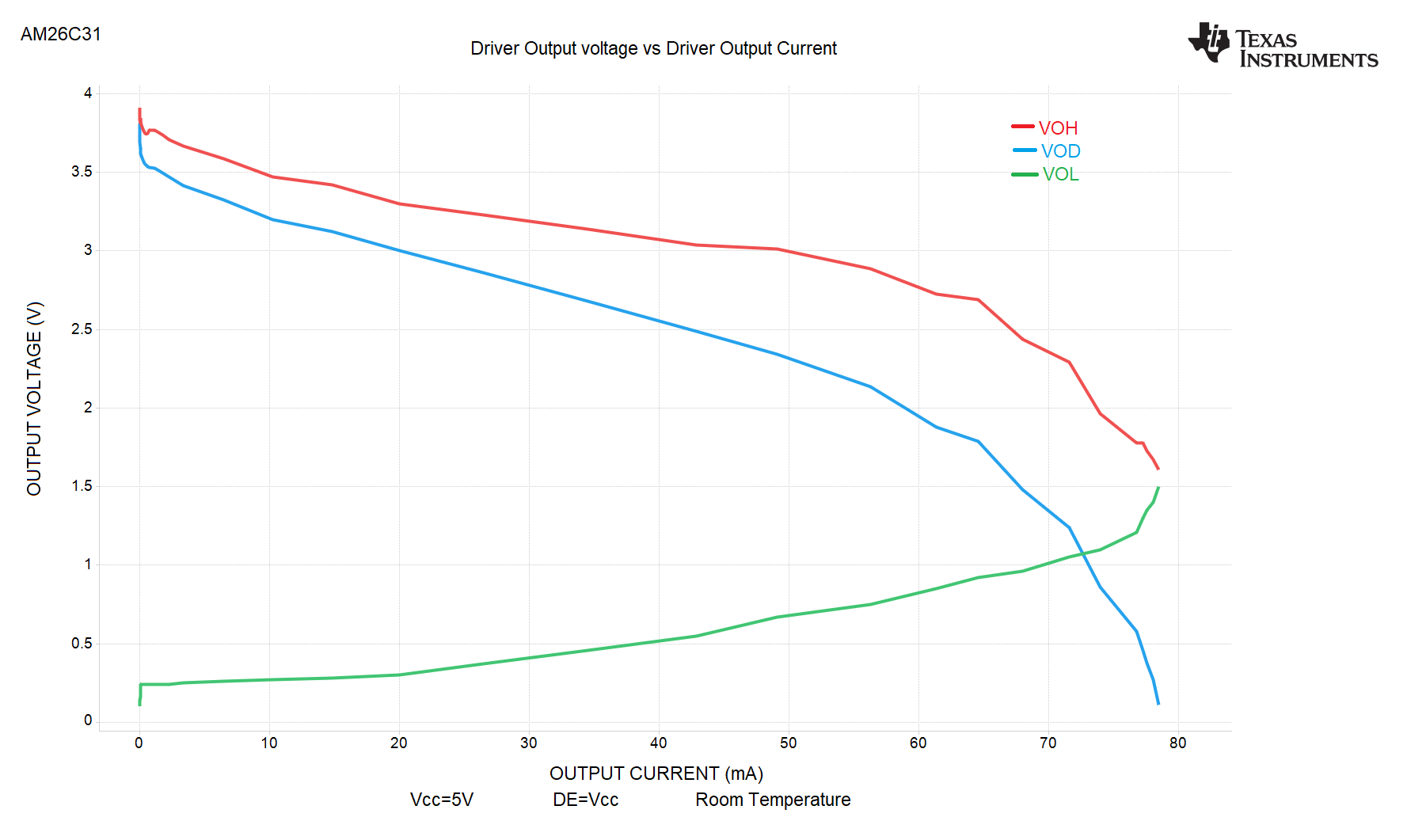

I’m looking for TI line driver AM26C31Q chart to show Voh as load increases? Any info showing output stage of the signals? is the using any internal push pull logic?
  • This device indeed has push/pull outputs; see figure 7.
    As an RS-422 driver, it is designed to generate a voltage drop of at least 2 V over a 100 Ω load. So the behaviour at higher output currents is not relevant, and thus not specified.
    It's possible to measure this, but there are no guarantees:
  • Hi Krishna,
    The driver outputs are shown in figure 7
    With RS-422 there should be a 100 Ohm resistor as the differential load and there is a guarantee of 2V across the 100 Ohm  over rec. operating conditions. Different loads are not advised. That is why different values are not included.
