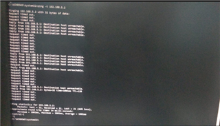

What are the other symptoms of failure you are observing?
Ans: Pls check the below register data link status is okay or Not?
Ans: we are only getting "Destination host unreachable/Request time out" response
Please do share any registers logs you might have collected previously.
Kindly check and confirm ASAP, where is the problem.
Rajesh
Hi Rajesh,
I see that the fiber side is not linked up. Register 0xC01 reads 6149 instead of 616D.
