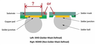

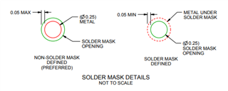

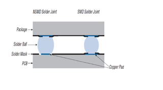

The recommended land pattern for SN65DSI83 is Φ0.25, but
However, we need to secure a clearance of 0.3mm in order to pass the pattern between the lands.
We would like to use the following land pattern only for the outermost circumference, but is it possible?
