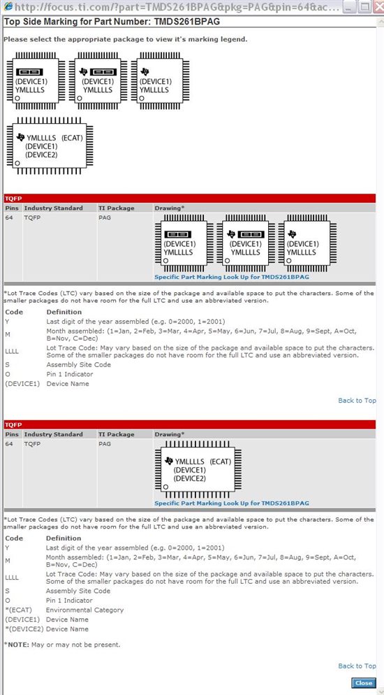

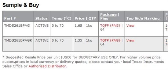

One more thing on these parts. I was looking for the product markings. It used to be a pop up from the product folders. Now there is a new link. The only thing it shows is just the part number, not date codes etc. is this correct? Am I missing something?
I found a link for it: TMDS261B: 2 to 1 HDMI switch Product Folder: Data sheet (PDF): TMDS251: 2-to-1 HDMI Switch Product Folder: Data sheet (PDF):
that worked, must of had my pop-up blocker on. Seems like the product folder is the way to go so I will jsut use that. Is the part marking lookup page something that still needs populating? The bottom of the product folder takes you here.
http://focus.ti.com/general/docs/partmarking/partmarkinghome.jsp
