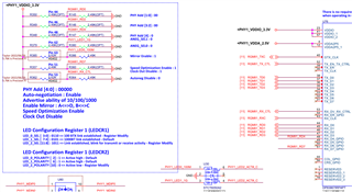

  • Hi Jason, Sean
    Reply as below
    • Check connection on eth1 (interface?) => eth1 & 2 interfaces are RGMII.
    • Check what processor is running both PHYs => Both PHY are DP83867IRPAPT.
    • Provide more details on setup (block diagram, schematic, etc.) => The block diagram is such as the below picture.
    • Confirm correct strapping of PHY => Yes, we have checked the strapping, Please refer below drawing.
      BR,
      Taylor

    • Double-check PHY addresses by reading bits 0 to 3 of register 6E =>
    When the error occurs the register bits 0 to 3 of 6E Reg are:
    bit : 4 3 2 1 0
    Val: 0 1 0 1 0 = 10

  • Sean and Taylor,
    I met with our Apps team and noted that:
    • There are different values from schematic and register reads provided for PHY Addresses of eth0 and eth1
    • For MDIO00 and MDIO01, do these correspond to PHY Address 00 and 01?
