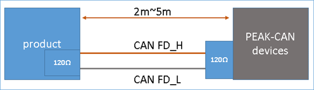

Now Customer use TCAN1044A for CAN FD at 5Mbps, monitoring through PEAK-CAN devices.
But the RX Error problem occurs.
We measured the TX/RX waveform and found Glitch on the waveform.
Regarding RX Error, how can we troubleshoot this problem, or what kind of information we need to provide.

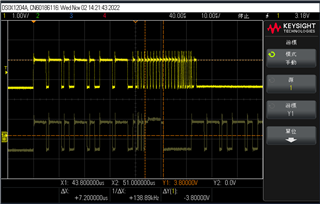

  • Hi Chris
    Please confirm that the attachment meets the requirements.
    In addition, we have found that this RX Error will disappear after a period of time (about 2~4 minutes).

  • Hi Chris
    The provided signal is the waveform of CAN_H, compare the difference between OK/NG.

    In addition, we have used NXP TJA1042, and RX Error did not occur

  • Hi Chris
    We are replacing TCAN1044 with TJA1042, other applications are the same.
    the waveforms of the scope are all CAN H, top is the waveform of OK, and bottom is the waveform of Error.
    the main is to compare the difference between the two waveforms.
  • Kygo,
    The point in the CAN frame that has a higher amplitude is showing multiple nodes transmitting at the same time. Since this is outside of the arbitration phase, what's likely happening here is that multiple transceivers are transmitting an error frame. The fact that a stuff error is getting reported indicates that there is likely a timing issue here. What is the sample point set to, and is it possible to give a bit more margin either earlier or later in the bit?
