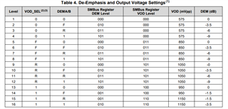

In addition, when debugging EQ and DEM, what is the recommended direction? Which one to call first?

    2). Suggestion is to set both EQ and DEM at the lowest level. Then increase EQ level first - one step at a time - until there is a valid eye opening. It is preferred to set DEM at the lowest or no de-emphasis and let EQ compensate for the data dependent jitter. After sweeping EQ levels, if sweeping through all EQ level did not provide acceptable eye opening - then one can set the EQ level at the lowest level with the DEM at a step higher then sweep the EQ level again. This can continue until optimum eye opening is achieved.

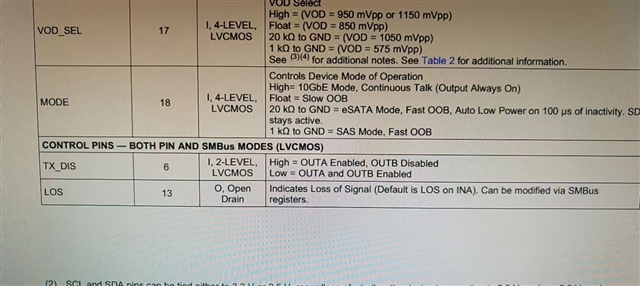

    Schematic shows pin 6 floating. Please pull this pin low through a 1K-ohm Resistor. Please note customer schematic shows this part as DS110BR111 - correct part number is DS100BR111.

    The customer's pin 6 forgot to pull down, can this be configured through the I2C interface? Thanks.
    Regards, Charlie
  • Hi Charlie,
    If customer is using SMBus slave mode, then TX_DIS can be configured through register 0x04. Set bit 5 to 1 to enable TX_DIS override and bits 4 and 3 to 0 to enable both channels A and B.
    Lucas
  • Hi Lucas,
    My customer has configured 0x04=0x20. OUTB still has no signal, But OUTA has signal.
    R&D have confirmed that registers can be read and written via SMBus. And pin3 has been set high.
    But When 4 is set to 1, OUTA still has signal.
    Now the feeling is that the registers can be read and written, but out A and OUT B cannot be enabled or disabled.
    What is the reason for this? What is the order of register configuration? Thanks.
    Our goal is to enable both A and B to output  signal.
    Regards, Charlie
