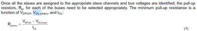

may I know how to determine Vol value ?
base on the pull-up voltage and pull-up resistor?
  • The I²C specification requires at most 0.4 V when using at most 3 mA pull-up current, or 0.6 V with 6 mA.
    (The VIL is required to be at least 30% of VCC, which is much higher than 0.4 V. But it is a good idea to have a noise margin.)
  • thank you for the quick reply.
    so, if I have a 3.3V pull-up voltage with 1k ohm to be the pull-up resistor.
    I`ll have the current 3.3mA, in this case, the Vol would be 0.4V, correct?
  • You do not choose VOL; it is set by the I²C specification.
    (3.3 V − 0.4 V) / 3 mA = 967 Ω (which you can see in figure 9-4)
    Please note that the PCA9545A is a passive switch; the pull-up resistors of all enabled channels act in parallel. If you can have two channels enabled, you need about 2 kΩ on each one.
  • Hi King,
    What Clemens is mentioning is correct.
    I am not sure what graph he mentioned in his previous reply, but do keep in mind his statement about PCA9545 being a passive device. When the switch is on, each channel will see pull-ups in parallel to one another. So if you have 4 channels on at the same time with 1kohm pull-up resistance, you will find yourself at an Req = 1kohm || 1kohm || 1kohm || 1kohm = 250ohm. I would suspect that your i2c bus would have trouble driving a LOW signal with such a strong pull-up resistance.
    Tyler
  • yes, we have trouble driving a low signal right now.
    you are saying if each channel has their own 1kohm pull-up, when 2 channel on, I will see only 0.5k ohm pull-up for both channel in total, right?
  • Yes.
    You should size the pull-up resistors so that the total curent of all channels that are enabled at the same time is no more than 3 mA.
  • Hi King,
    Yes, channel that is on will see their respective pull-up resistors combined in parallel resulting in a stronger pull-up resistance to VCC. Please follow Clemens' suggestion.
