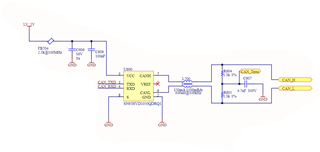

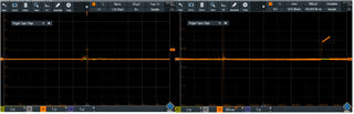

Hello TI. We are using the SN65HVD1050QDRQ1 in a design. Schematic above. The pulse train for from CANL and CANL do not look like nice squarewaves. a lot of ringing on the peaks. Is it normal. Picture of CANH and CANL below.
Signals into RX and TX look nice..
Transmissions from the equipment to the CAN transceiver chip look nice.
