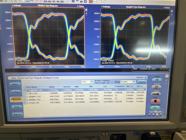

When measuring DS90UB941AS-Q1 eye diagram, it was found that there would be a back groove. Is this an abnormal condition? Does it affect product quality? thank you

Hi Yuming,
I am not sure I understand the question you are asking, can you clarify what it is you are asking about?
For the eye, since this is a measurement of the DSI CLK, as long as it meets the specs found in the datasheet regarding eye height, clock jitter and DSI receiver, it should be fine.
Please take a look at the below FAQ thread regarding DSI clock jitter measurement:
Shu
Hi Yuming,
Are you seeing any issues in your system? Since this is a measure of the DSI signal into our device, I recommended referring to the MIPI-DSI specifications to ensure the DSI source is adhering to the requirements.
