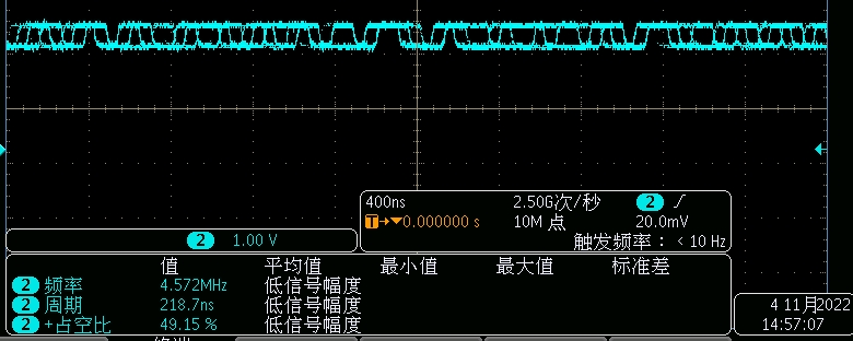

3. Why only supply power to the deserializer (no signal)? RIN0 -, RIN0+will have waveforms as follows:
4. How the above waveform is generated.
    Since the channel is bidirectional, there will be a signal sent by the DES in the reverse direction.
