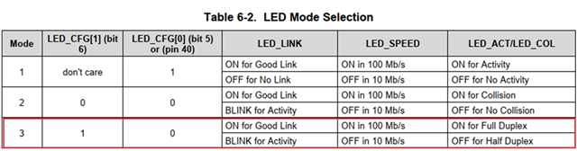

Hi Team,
After auto-negotiation, LED_SPEED turns on for a moment when link down occurs due to cable removal while operating on 10BASE.
Do you have any solution?
It is selected LED Mode 3, so LED_SPEED is turned off in 10BASE.

Hi Takahashi-san,
We are in the process of characterizing and replicating this behavior - please allow us some time for this.
Thank you,
Evan
Hi Takahashi-san,
Thank you for your patience - I have not been able to replicate this behavior. Are there any issues in your application caused when LED_SPEED turns on momentarily?
Evan
