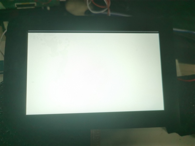

Hi team,
One of our customer's issues, I'm forwarding it below, could you please provide some troubleshooting suggestions
Deserializer: DS90UB926Q-Q1
Display: Rgb888 800*480 5-inch,
No serializer and LVDS input, Only 926 screen connected

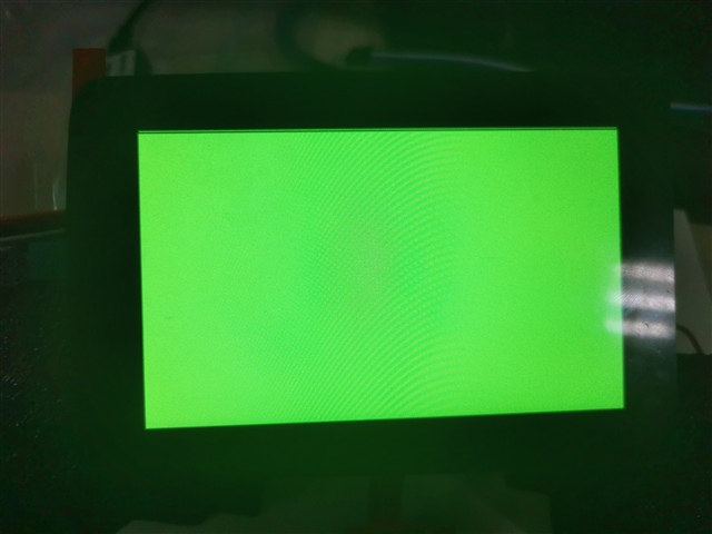

Using the 926 internal pattern generator to light up the screen. I find that sometimes the display is normal after I power up, sometimes the display is abnormal like the picture below. Black lines are displayed.
The top(white) image  is missing part of the left side with black lines on the top. The bottom(green) image is complete on the left, but there are black lines on the top.
When power-up display is normal, the picture stays for a little longer, it will automatically appears abnormal like the white image, or green image, or splash screen

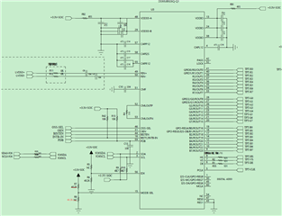

Please check if there is a configuration error, or if there is anything else that needs to be configured, or DE HS VS needs to be modified on hardware. Currently these three pins are series of 100 Ohm resistors connected to the display. The 926 is configured as follows
(0x01, 0x04)
(0x02, 0xFA)
(0x03, 0xF0)
(0x04, 0xFE)
(0x05, 0x2E)
(0x06, 0x00)
(0x24, 0x08)
(0x29, 0x60)
(0x2A, 0x00)
(0x2C, 0x00)
(0x41, 0x03)
(0x44, 0x60)
(0x56, 0x08)
(0x65, 0x04)
(0x64, 0x11)
Amy Luo
