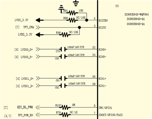

We built a new mainboard and the TFT panel will shaking.
1:Modify the temperature parameters of 948---NG;
2:Modify the output voltage of SOC---NG;
3:Modify the output current of SOC---NG;
4:Measure the Lock Pin of 948---Always Lock;
5:Measure the V1.1 and V1.8 of 948---no abnormal conditions;
Can you get me some suggestion about this issue?

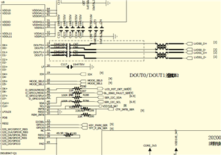

  • Hi William,
    Thank you for replying,we had integrated the 947 into schematic.
    The 947 and 948 connected in Dual FPD mode,and we use Dual OLDI.
    What do you mean of the bringup scripts? Is the code of 947's initialization?
    It does not happen to evevy device, we had done AB swap and it following the 947.
    This is the register map of 947 and 948:
    This is the topology:
    Best Regards!

  • Hi William,
    We had fixed this issue,the video IC causing this bug, thanks for you reply.
    Best Regards.
