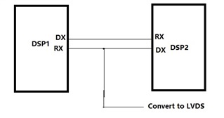

In our project, two DSPs are interconnected via McBSP interface to perform the functions. In order to verify the function, we have to capture the traffic b/w these two DSPs.

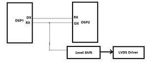

My proposal is to create a test point on the board and convert the signal into LVDS. The LVDS will be measured by the specified measurement devices. Please see the image below.
I reviewed the SLLA105 <DSP to DSP Link Using LVDS>, it seems the above solution works. Please TI experts help confirm the solution, or please provide alternative approaches.
