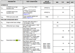

  • Hi Elec,
    Correct, we need some time to lock and this is dependent on system. Below is the spec that includes the typical value for lock time.
    Glenn
  • Hi Gelnn,
    Just double confirm with you, will the lock time account for the video time delay during normal working? That is to say, when I am calculating the time latency from 935 input and 960 output, should I add lock time also? In the e2e link I attach above, he doesn't mention this. So I am not sure. Nee your help to confirm. Thanks.
    BR,
    Elec Cheng
  • Hi Elec,
    On the previous E2E you referenced he is assuming the system is lock and stable. The time it takes for video to come into the ser to the des is small enough no impact significant impact on the system. From des to the SoC is what is the previous E2E is indicating worse case is 2x time the line period.
    If you want to take consideration, please look at the power up sequence in the datasheet that explains timing. This lock time, VDD power up, Etc.
    Glenn
  • Hi Glenn,
    So if the lock is stable and  I want to calculate delay time, now we don't need to take lock into consideration, right? Thanks.
    BR,
    Elec Cheng
  • Hi Elec,
    Correct, if you are locked and stable, you don't need to take lock time into consideration.
    Glenn
