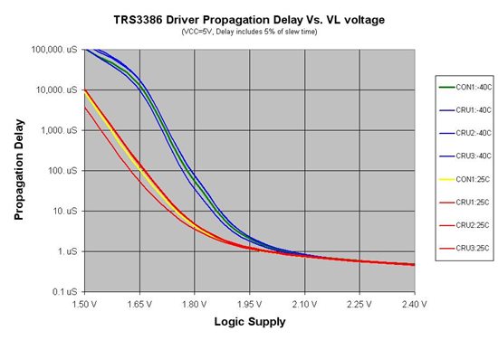

  • Nikolau,
    Here is a chart I made during the evaluation with customer returned units (CRU) and a sample unit (CON).
    Data was recorded at 25C and -40C, 0C can be interpolated. The 1.8V VL is on a steep prop delay slope, so the application's minimum VL must be considered.
    The most important considerations are bit rate (actually bit time) and minimum VL. The driver signal will become unreliable just before prop delay equals bit time.
    Let me know if you have questions about applying this chart to your application.

    Ron,
    thank you very much for this analysis.
    So it looks as if we are at the corner of these curves.
    We run the 3386E on the UART3 of the OMAP3530 which by default has 115200 bit/s. And, we usually operate this interface at 20-24 C. But the OMAP system can heat up the whole board. Finally, the TPS65950 provides the 1.8V VIO specified with +/-4%. This means 1.73 - 1.87 V.
    So we will have up to 20uS @ 1.74 V / 0C. This would be beyond 1 bit time.
    But the typical operation point would have 5 uS @ 1.8V / 25C which is half of a bit.
    Another question: your curve is specified for VCC=5V. Does this have an influence? What about VCC between 3.2 and 4.2 V (directly driven from a LiIon battery)?
    And one more: will there be an upgraded chip? The TI chip is a little cheaper than the proposed second source :)
    Thank you very much,
    Nikolaus
  • Nikoluas,
    The voltages that matter are VL and V+, The boost supply is regulated, so VCC has little effect, but lower VCC generally reduces V+ a little (better prop delay). Heavier RS232 load generally increases V+.
    I have the raw data pasted below. I also have an logiritmic interpolated 0C prediction. VL is in Volts and other other numbers are prop delay in uS.
    VL CON1:25C CON1:-40C CRU1:25C CRU1:-40C CRU2:25C CRU2:-40C CRU3:25C CRU3:-40C
    3.5 0.34 0.39 0.38 0.4 0.34 0.37 0.34 0.39
    3 0.37 0.39 0.36 0.38 0.35 0.37 0.34 0.39
    2.5 0.43 0.43 0.43 0.42 0.42 0.42 0.41 0.42
    2 0.97 1.32 1.02 1.39 0.97 1.22 0.97 1.41
    1.8 4.3 55 4.96 79 3.54 36 4.78 75
    1.65 108 12800 152 17100 54 9720 138 17500
    1.5 8840 108000 10500 140000 3640 110000 10400 164000
    VL CON1:0C CRU1:0C CRU2:0C CRU3:0C
    3.5 0.36 0.39 0.35 0.36
    3 0.38 0.37 0.36 0.36
    2.5 0.43 0.43 0.42 0.41
    2 1.09 1.15 1.06 1.12
    1.8 11.46 14.38 8.64 13.78
    1.65 678 935 398 889
    1.5 23148 28435 13503 30042
    I consider it risky to use the device at 1.8V espically at 115,200bps.
    Ron.
