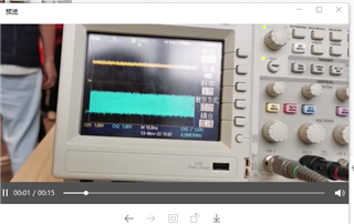

    Today,we we dumped all the registers .The third line.0x4e and 0x4 is abnormal compared with the second line.
    We measure the pass and lock pin.
    the blue one is the pass pin.
    Could you provide some suggestion to solve this issue?

  • I checked the hardware  design. 954 uses the ext 50Mh osc and 953 uses the ext 25Mh osc. The mode is CSI MODE non-sychronous.
    So I am wondering it is reasonable or not.
  • Hi ,
    Newest  update is that when only generate 954 the pass and clock signal is high continously.
    When setting register 0X58 from 0X1a to 0X9a or ox5a. The signal will become abnormal again.

    Glad to hear that the pat gen issue is resolved. This video, which goes over all of the diagnostics and built in checks of the devices, should be useful.
    Can you explain the differences between the two rows and the different sets of registers you have posted? Are these all showing the same thing or have settings been changed?
    In regards to the oscillators the 954 requires a 23-26 MHz reference clock. The 50 MHz is outside of this range and is not supported, this is likely the reason why you are seeing abnormal behavior. Please update the refclk signal to be between 23 and 26 MHz.
  • hi,
    I got something wrong with the osc. 954 uses the ext 25Mh osc and 953 uses the ext 50Mh osc.
  • Okay those oscillators will work. Could you explain the difference between the sets of registers you have posted, are they for the same set up? What abnormal behavior are you seeing? Is lock unstable?
  • Hi Darrah, below is the important difference:
    1.0X4e register bit1 always shows cable fault
    2.0x4 sometimes will be 0xd3,sometimes will be 0xdf,which shows the lock and pass  signals sometimes are low and sometimes are high, which is unstable.
    3.Thirdly, when writing 0x5e to register 0x58. the lock and pass signal will be low completely.
    So we dump the registers for your refenrence to diagnose the cause.
  • Besides writing to register 0x58, is there any difference between the register values in column 2 and column 3? I want to make sure that there aren't any other variables such as the set up that could be causing the instability. It looks like column 2 has an STP configuration and column 1 has coax. Did the two columns come from the same devices? Have you verified that there is not a cable fault anywhere?
    Setting register 0x58 to 0x5e will set the back channel to 50 Mbps, which is for synchronous mode. Since you are using nonsynchronous mode, the back channel will need to be 10 Mbps, which means the register value should be 0x58[2:0] = 010.
