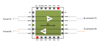

“One of our platforms implements the TI TUSB522p redriver on a USB host controller.
 We would like to conduct some experiments which require removing or bypassing the redriver on the USB path.
 I am reaching out to obtain some guidance as to what the connections are required to remove the redriver but keep the USB port functional.
2: We have the TI USB RE-DRIVER TUSB522P on our SS port on the AMD server reference platform and are having issues getting the port to pass the USB compliance TD1.09 test .   This is the interface test
  • for Q1: you need to connect RX1 to TX1 and TX2 to RX2 to by pass redriver. You can use 0 ohm resistor to connect host TX to connector TX and host RX to connector RX

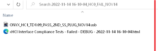

  • Hi Brian,
    Can you please help take a look at the attached USB logs?
    AMD is reporting a failure of TD1.09 test when running USB compliance.
    APPLICATION: xHCI Command Verifier
    TEST SUITE: xHCI Interface Tests.cvtests
    OPERATING SYSTEM:
    WORKSTATION:
    DATE: Monday, November 14, 2022
    TIME: 04:13:18 PM
    OPERATOR: Administrator
    NUMBER OF TESTS: 1
    LOG NAME: xHCI Interface Compliance Tests - 2022-11-14 16-10-04
    RESULT: failed
    2: We have the TI USB RE-DRIVER TUSB522P on our SS port on the AMD server reference platform and are having issues getting the port to pass the USB compliance TD1.09 test .   This is the interface test”

  • Jiahong:
        What is this CV test? Do you have test description for TD1.09?
        Also for trace log of fail, it shows HC1-2nd-pass, it's pass or fail? Almost same as the other one
    brian
  • I listed the failed logs/trace on the TI redriver port. The other is passing log/trace on the non-redriver port. Customer would like us to review the data and compare as per the redriver spec? I will ask them for test description of TD1.09.

  • So this is the trace for failed one with redriver?
  • ok, let me check again, unplug in the trace look similar to the good one.
    regards
    brian
