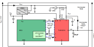

    Please update the datasheet and associated information for this chip to clearly define what pins states should be when their functionality is not used, for instance WAKE can be tied either HIGH or LOW to VSUP, as per information in on this forum - this information is however missing from the datasheet, which is poor as instructions go.
    Sorry that the datasheet is confusing, this is a rather complicated device when it comes to transceivers. We have multiple diagrams throughout the datasheet that show how you can connect the WAKE pin including one in the typical application section:
    If the WAKE pin is unused it can be tied to VSUP or GND. You don't need any kind of resistor. This will just remove the LWU functionality from the device.
    As per datasheet and information on these forums, I have made modifications to my PCBs that ties INH to GND through a 100k resistor, we were toggling the EN pin using a GPIO of a MSP430 associated processor, however I believe this was leading to timing issues as stated in the datasheet and the state-machine description, the EN pin should be enabled at start up, so I have cut the track and pulled it HIGH through a resistor to 3.3V, please advise whether this is still suitable, or whether it should be pulled directly to 3.3V, without a resistor.
    You can just leave the INH pin floating. This is an output pin and does not need to be tied to any logic level. What timing issues were you running into? The EN pin can be pulled high externally from the device to keep it in normal mode. But you should still have some connection to the MCU if you wish to toggle between normal and sleep mode.

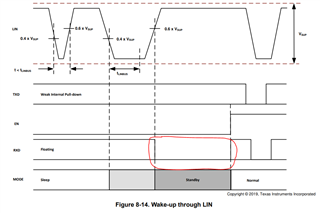

    We are sending an 11-bit low wake up request on start up, but the TLIN1021 does not come out of this indeterminate mode. I have measured the behaviour and Tx is being pulled HIGH, Rx is sitting LOW. We are currently experimenting with toggling our dominant LIN bus, to see if we can initiate a wake-up request, which by all other means seems to be ignored.
    The LIN transceiver will not automatically transition out of standby mode after a wake request. What happens is the device will report this wake request on the RXD pin by pulling it low:
    It is not up to the transceiver to drive the EN pin high that is actually the job of the MCU to transition the device to normal mode by driving the EN pin high.

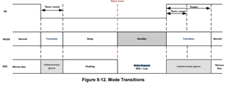

    We document how our device transitions in our state diagram below:
    What you'll notice is that everything is controlled by the EN pin and there are other fault cases that can transition the device into other modes.
    It sounds like you are receiving the wake request on the RXD pin since it is sitting low after you send the 11-bit low wake up. Now you have to have your MCU read this low and drive the EN pin high.

    Chris's response is correct. Ultimately, I worry there might have been some confusion between the functions of the different pins. Keep in mind that the EN effectively turns the device on and off (specifically brings the device into and out of Normal mode).
    Communication is only possible in Normal mode. If EN = high and power is supplied, you will be in Normal mode, capable of communication, unless an undervoltage or thermal shutdown condition exists.
    WAKE events can occur in multiple forms. They could be wake-up frames (WUF), as you described below as a long dominant signal. They could also be local wake-up (LWU) events, which are simply high-low or low-high transitions on the WAKE pin (battery level, not VCC).
    EN = high will bring you to Normal mode whether you were in Sleep or Standby. Powering on with EN = high will bring you to Normal mode.
