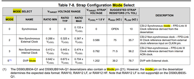

Our customer want to use 935 pair with 934. They can only use DVP mode, right?
Then how about 934 clock? Does it need an external clock source? What clock does 943 refer to? Thanks.
Correct.
If you check Mode #5 on the Table you attached, you can see DVP with External Clock, which means using an external Clock source connected to the SER is a must. Using this mode, the DES will use this clock which will be coming on the FC.
