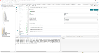

    May I kindly ask what is the value you have set "Min DMA Transfer Size"? This value can be set using SysConfig  > TI Drivers > SPI > Min DMA Transfer Size
    I hope this will help,

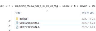

  • Hi.
    I downloaded the files SPICC23XXDMA.c / SPICC23XXDMA.h and copy pasted them into ti\simplelink_cc23xx_sdk_6_30_00_20_eng\source\ti\drivers\spi.
    I am using the simplelink_cc23xx_sdk_6_30_00_20_eng example code as it is.
    And I set the minimum DMA transfer size to 10.

    Thank you for the details provided.
    This actually does NOT patch the SPI code.
    To patch the SPI, you should copy the files in your CCS project:
    1. Open CCS
    2. Import the project you want
    3. Copy the two files from the MSR repository
    4. Paste the files in the CCS project
    5. Rebuild the project (right click on the project, "Rebuild Project)"
    Once the previous is done, please run a new test.
    Then, you can consider trying to increase the "Min DMA Transfer Size".
