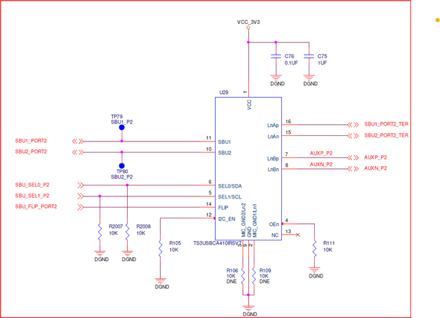

TS3USBCA4: FLIP selection Pin swapping issue
Part Number: TS3USBCA4
Hi Team,
I am using TS3USBCA410 in my design to switch between 2 SBU circuits and I have come across a flip pin enable issue.
As per the datasheet, I have provided logic 0 for the FLipSEL Pin yet the IC swaps the SBU1 and SBU2 at the output. I have cross-verified my circuit to see if there is any glitch in it and it seems to be fine.
Let me know if you have come across one switch issue because if the FLIPSEL pin is made high then the SBU1 and SBU2 are working in normal orientation. let me know your feedback.
